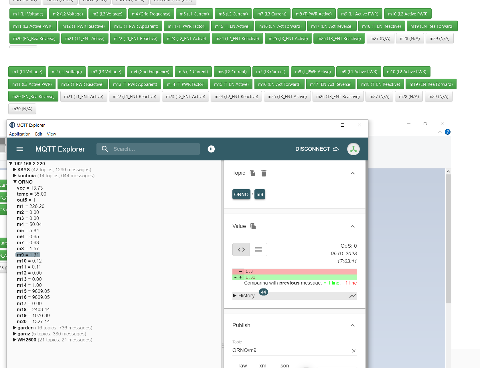

Dzięki za podpowiedź. Sprawdziłem też wersję 1.52, ale efekt jest ten sam:
w zakładce Klient MQTT zaznaczam klawisze powyżej m20 jak na załączonym screenie, zapisuję ustawienia i niestety nie są pamiętane (ani transmitowane do broker MQTT).
Zaznaczanie działa tylko do m20.

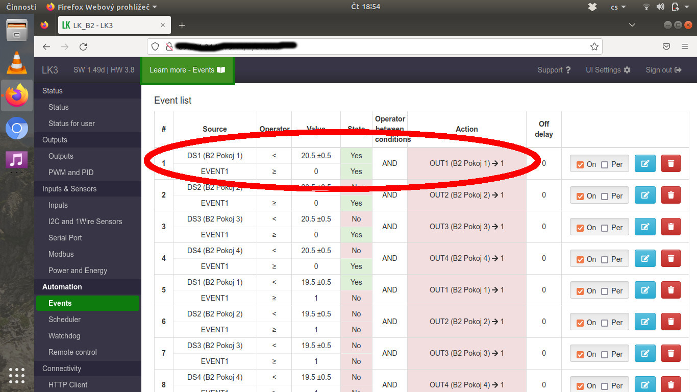

1. LK spontaneously changes positions of DS sensors.
2. In events the “on delay” is not working.
3. at PWM outputs “active low” function is not working.
After this I did a downgrade to 1.49 version, because I need the DS sensors to work properly.
In 1.49 version these errors occurred:
1. when I use events combined with scheduler over variables event 1,2… sometimes, the event is not performed (it does not switch the output), even when the conditions are met. (after restart everything is okay) - on the picture below.
2. During editation in existing events, after saving, one event appears twice and spontaneously another event deletes (this mistake was already notified on this forum). Link
