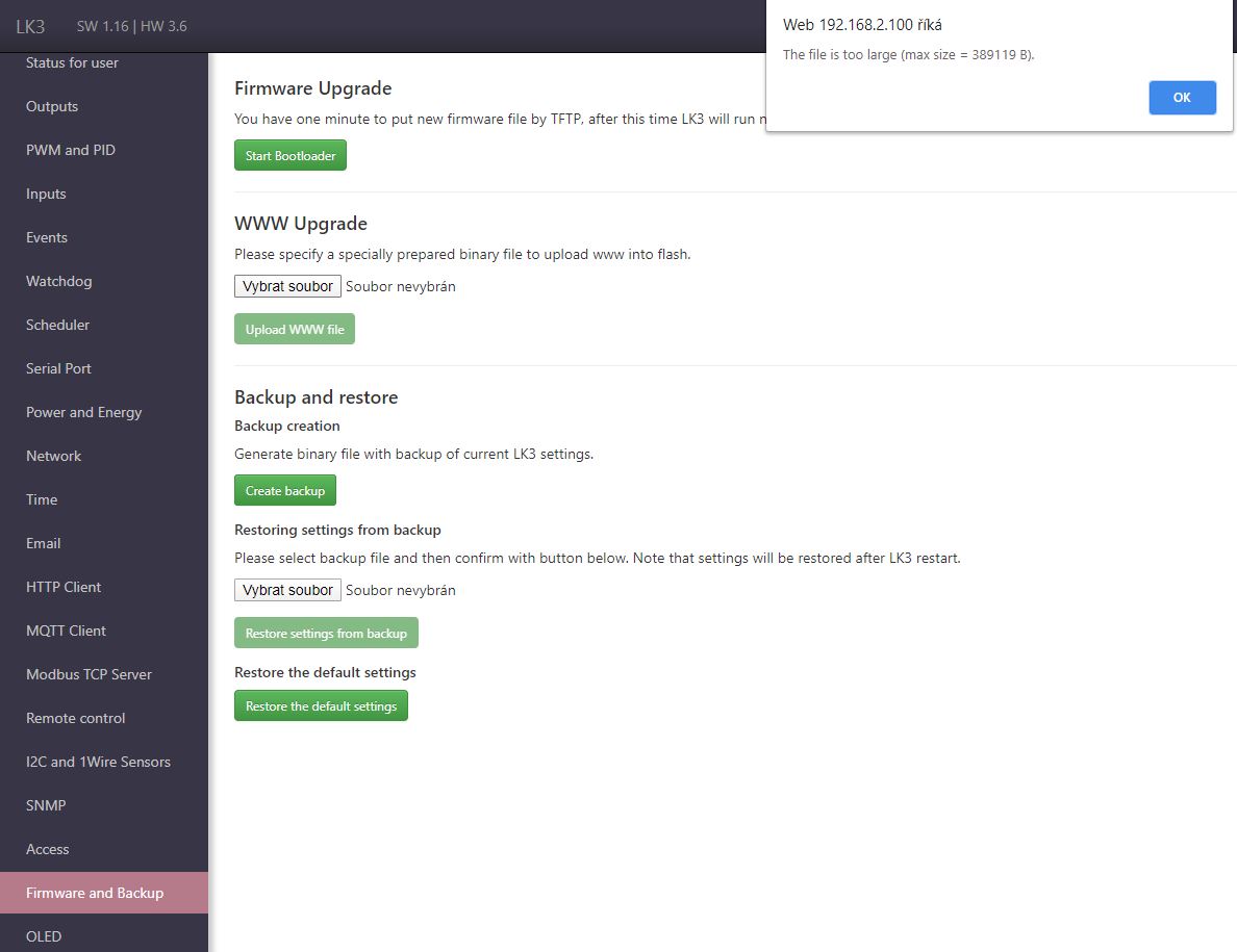

i have LK 3.6  - frist firmware update from ver. 1.10 to 1.16 no problem
now i want update firmware to 1.22c  and always problem " File is to large "
what is wrong ... thanks guys .. Big Grin Big Grin
ok my bad now i use TFTPD32 Wink
