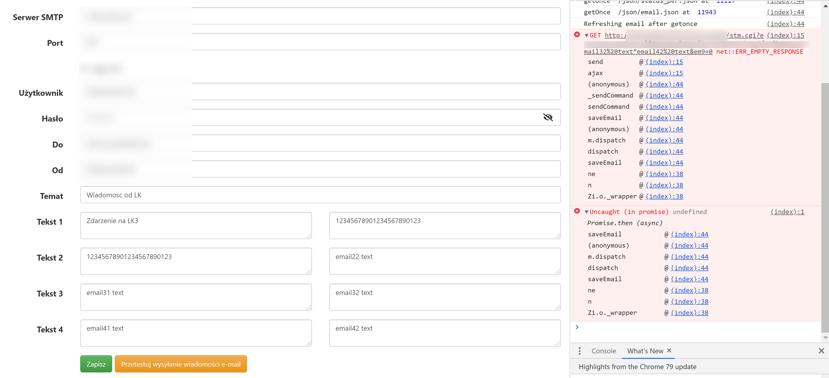

RE: LK3.5-NOWY SOFT - KOLEJNE WERSJE - wilkxt - 12-28-2019 Http url adr2,3 and 4 are only to send by Events, not periodic sends RE: LK3.5-NOWY SOFT - KOLEJNE WERSJE - mavar - 12-29-2019 Hello First off all, I would like to thank you for your effort to develop LAN Controller. I’ve just installed new FW 1.21 and it looks good, but I have some minor questions: A. Email messages It looks, some characters like colon, new-line, square bracket… is not possible to save and use. Does exist some way how to use it? Do you plan to allow use more than one email (SMS) contact (for different Events) in the future? B. Ultrasonic distance meter Can you please specified little bit more, how to connect this sensor to LK3.5? I’ve found “distance meter” option on Events config page but not in Input page (maybe I’m wrong). Can be also this sensor https://www.aliexpress.com/item/32911119661.html (in PWM version) used? C. Power and Energy Do you plan to allow configure units in this section. I used impulse counters also for flow meter, so I would like to change Watts to Litres D. „backup battery connected to connector behind INPxD inputs” The mentioned connector is in manual marked as “RTS battery socket”, am I right? Which battery can be used? Thank you very much for any help you’ll provide Martin RE: LK3.5-NOWY SOFT - KOLEJNE WERSJE - wilkxt - 12-30-2019 (12-29-2019, 01:32 PM)mavar napisał(a): A. Email messagesWe're working on how to solve this. Yes, we plan add more conntact to sms and email. (12-29-2019, 01:32 PM)mavar napisał(a): B. Ultrasonic distance meterDistance meter is on "serial port" page. Communication is by UART (TX,RX) not PWM. You must connect JSN-SR04T-2.0 (work in mode 2) to UART_RX, UART_TX,GND and +5V on IDC10-1. Regarding the sensor from the link, it works in PWM or UART mode, LK supports UART mode, but I don't know if it will work with this sensor, no specifications. If you find the specifications of this sensor then I will check it. (12-29-2019, 01:32 PM)mavar napisał(a): C. Power and Energy Yes, we add (12-29-2019, 01:32 PM)mavar napisał(a): D. „backup battery connected to connector behind INPxD inputs”Yes, RTC battery socke. You can use any battery with voltage from 2.5 to 3.3V, e.g. CR2330 RE: LK3.5-NOWY SOFT - KOLEJNE WERSJE - mavar - 12-30-2019 (12-30-2019, 12:38 PM)wilkxt napisał(a):(12-29-2019, 01:32 PM)mavar napisał(a): A. Email messagesWe're working on how to solve this. RE: LK3.5-NOWY SOFT - KOLEJNE WERSJE - wilkxt - 12-31-2019 (12-30-2019, 08:00 PM)mavar napisał(a): [/color]-> I found these "docs" more specifying mentioned sensor, but I dont know, if there are sufficient... https://github.com/riteshRcH/waterproof_small_blind_ultrasonic_sensor_DYP-A02YYxx_v1.0It should work with firmware 1.21 RE: LK3.5-NOWY SOFT - KOLEJNE WERSJE - agrest - 12-31-2019 Znalazłem błąd: W treści maili nie można wpisać znaku "-". Pojawia się komunikat "Tekst - Nie może mieć mniej niż 0 znaków i więcej niż 159 znaków" Dodatkowo przy wypełnieniu pół jak w załączonym zrzucie nie idzie zapisać zmian. Wygląda jak gdyby przy pewnej ilości znaków (suma ze wszystkich pół) następował błąd. RE: LK3.5-NOWY SOFT - KOLEJNE WERSJE - wilkxt - 12-31-2019 (12-31-2019, 10:45 AM)agrest napisał(a): Znalazłem błąd: W treści maili nie można wpisać znaku "-". Pojawia się komunikat "Tekst - Nie może mieć mniej niż 0 znaków i więcej niż 159 znaków" Dodatkowo przy wypełnieniu pół jak w załączonym zrzucie nie idzie zapisać zmian. Wygląda jak gdyby przy pewnej ilości znaków (suma ze wszystkich pół) następował błąd. Tak, będziemy to poprawiać RE: LK3.5-NOWY SOFT - KOLEJNE WERSJE - mavar - 12-31-2019 (12-31-2019, 09:40 AM)wilkxt napisał(a):Thank you. I'll try(12-30-2019, 08:00 PM)mavar napisał(a): [/color]-> I found these "docs" more specifying mentioned sensor, but I dont know, if there are sufficient... https://github.com/riteshRcH/waterproof_small_blind_ultrasonic_sensor_DYP-A02YYxx_v1.0It should work with firmware 1.21 RE: LK3.5-NOWY SOFT - KOLEJNE WERSJE - xdedek - 01-22-2020 Hello, I encountered another problem. Occasionally, LK stops responding to "events" and, even if the conditions are met, does not take the appropriate action. In the previous version of FW it did it more often, sometimes every 14 days. In version 1.21 it did it after about 3 weeks. Only a restart will help. printscreen is attached RE: LK3.5-NOWY SOFT - KOLEJNE WERSJE - mavar - 01-23-2020 (01-22-2020, 08:50 AM)xdedek napisał(a): Hello, Completelly agree. I saw the same in FW1.21 (I hadn't used Events before). In one case It looked as LanKontroler is overloaded (slow reaction in Control panel) |
