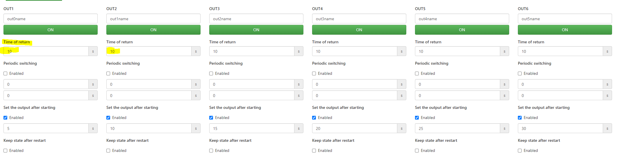

#4
Wink
Thanks for the update but it did not solve the issues that i had
I noticed that in the new firmware it is not enabled (Set the output after starting) as Default
When I enable <Time of return> and turn OFF the output from <Status>, <<Status for User> or<Outputs>
Does not revert to ON remains Off (Time of return not Work)
If I go back and turn it ON it will go back to OFF (Time of return  Work)
If I change fast ON OFF It does not return to ON (Time of return not Work)
Also when I cut and restore power to the PDU
the outputs Will become ON because  I have enabled <Set the output after starting>
but then it turns OFF because of the <Time of return>
I also haven't found a way to reset all the output with one command (Off -ON)
#5
ok, we fix this i next firmware
