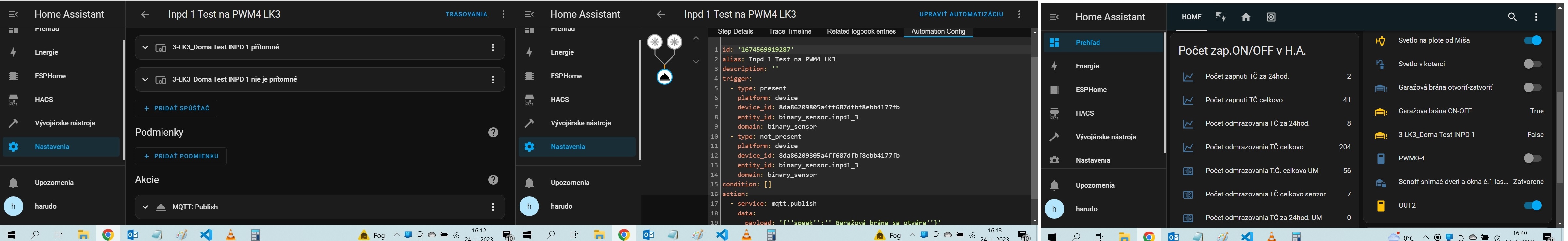

I want to ask, I have LK3 and on the Inpd1 input I have a sensor Inductive sensor SN04 N1, NPN NO also works in actions in orig. LK3 is switched on / off via the web setting, e.g. out2. But in the Home Assistant integration, it shows me in the on/off log, but it doesn't start the automation in HA, I have 3 pieces of LK3, the same thing happens. Simply changing the state of Inpd will not turn on any other device in the automation. Where is the problem? well thank you
And after changing the satv, both the icons are still lit at INPD.
#16
Thumbs Up
Hello boss Cool . Is it possible in the next update (integration of LK to H.A.) to fix INDP1,2,3,4 when it is connected there e.g. open door sensor to work in Home Assistant in automation. (binary_sensor.inpd1). Because the sensor works ON/OFF but no automation is performed. Otherwise, the INDP icon does not light up either. Smile Thank you  Smile
